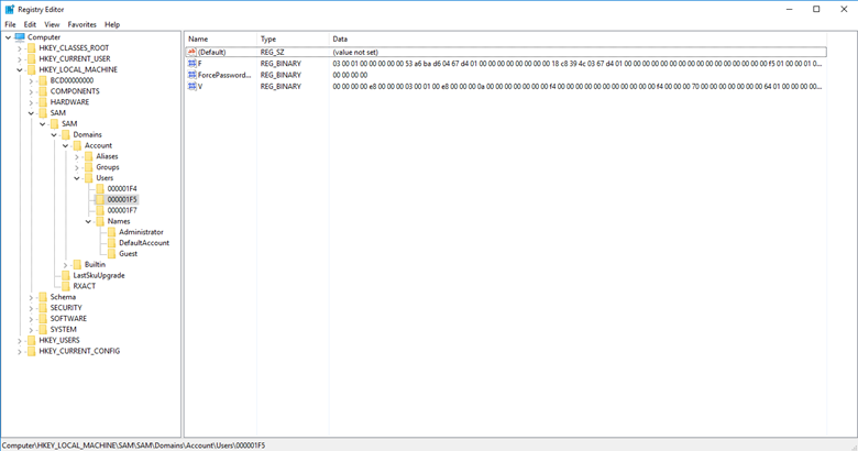

Step 1. In the Registry Editor, look under the SAM key for the Users subkey. Then click 000001F5 to view the details of the Guest account:

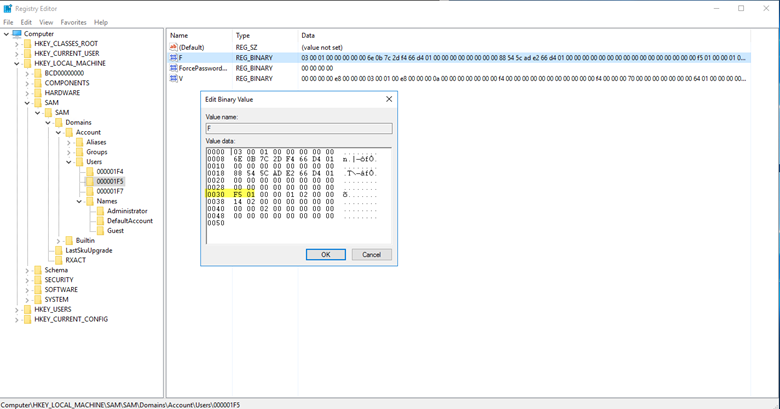

Step 2. The F value stores the RID of the account. To edit that value, right-click it and select Modify from the menu. The Edit Binary Value window will open:
Step 3. At offset 30 is the value 0x1F5, which is the RID of the Guest account. Simply change that value to 0x1F4, which is the RID of the Administrator account.

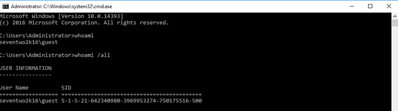

Running the whoami command under the Guest account confirms that the Guest account now has the Administrator RID, which is the last part of the SID displayed (500 in decimal):
