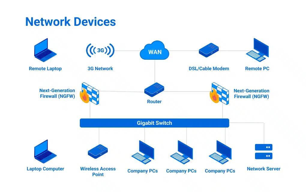

What is a network device?
A network device is a hardware or software component essential for communication between computers and other connected systems. These devices manage traffic flow, direct data packets, provide security, and enable connectivity between network segments or the internet. Each device serves a specific purpose, enabling information to flow within an organization's IT ecosystem.
Common network devices include routers, switches, firewalls, hubs, modems, and wireless access points. Some devices, such as switches and routers, move data. Others, like firewalls and intrusion detection systems, control which traffic is permitted and flag traffic that appears malicious. Most modern networks rely on both categories working in coordination.

Types of network devices
Understanding the different types of network devices helps you optimize and secure your organization's network infrastructure. The table below maps each device to its OSI layer and primary function, followed by a detailed breakdown of each type.
Network Device | OSI Layer | Primary Function |
Repeater |
Layer 1 (Physical) |
Amplifies and retransmits signals to extend range |
Hub |
Broadcasts signals to all connected ports |
Bridge |
Layer 2 (Data Link) |
Connects and filters traffic between network segments |
Switch |
Layer 2 to 3 (Data Link/Network) |
Directs data to specific ports using MAC/IP addresses |
Router |
Layer 3 (Network) |
Routes data packets between different networks |
Gateway |
Layers 4 to 7 (Transport to Application) |
Translates data between different network protocols |
Network Interface Card (NIC) |
Layers 1 to 2 (Physical/Data Link) |
Connects a device to a network |
Modem |
Converts digital data for transmission over analog media |
Firewall |
Layers 3 to 7 |
Monitors and filters traffic based on security rules |
Wireless Access Point (WAP) |
Layers 1 to 2 |
Connects wireless devices to a wired network |
IDPS |
Layers 3 to 7 |
Detects and prevents network intrusions |
VPN Appliance |
Layers 3 to 7 |
Creates encrypted tunnels for secure remote access |
