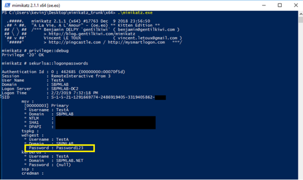

For example, suppose the user “TestA” used remote desktop to log on to a machine, leaving their password in memory. The screenshot below illustrates what an attacker would see when dumping credentials from that machine’s memory using Mimikatz. As you can see, they get both the NTLM password hash for the account and the clear-text password “Password123” as well.
WDigest Clear-Text Passwords 1

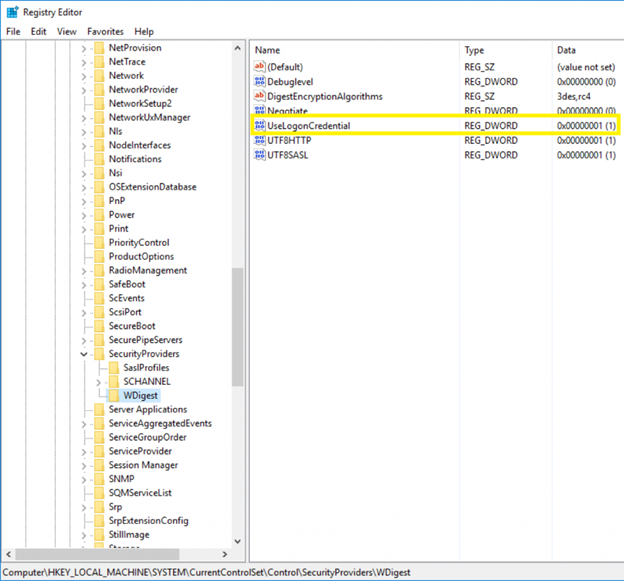

For Windows 7, Windows 8, Windows Server 2008 R2 and Windows Server 2012, install update KB2871997 and then set the following registry key to 0:
WDigest Clear-Text Passwords 2

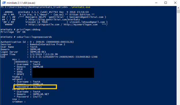

Once this registry value has been set to 0, an attacker dumping credentials out of memory wouldn’t get the clear-text password; instead, they would see this:
WDigest Clear-Text Passwords 3

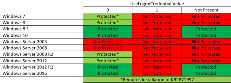

Reference Chart
Here’s a chart to help you determine if you need to take action on your endpoints:
WDigest Clear-Text Passwords 4
