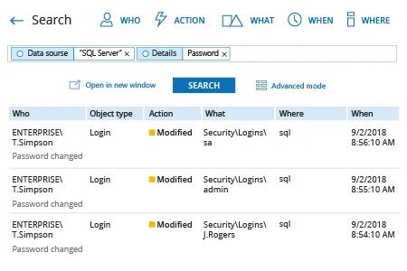

  1. Run Netwrix Auditor → Navigate to "Search" → Click on "Advanced mode" if not selected → Set up the following filters:
    • Filter = "Data Source"
      Operator = "Equals"
      Value = "SQL Server"
    • Filter – "Details"
      Operator = "Contains"
      Value = "Password"
  2. Click the "Search" button and review what changes were made to passwords.

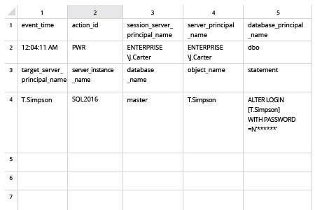

  • To view login password changes, execute the following code in SQL Management Studio:
      SELECT * FROM sys.fn_get_audit_file ('\\SQL\Audit\*',default,default)
WHERE action_id = 'PWR'
GO
  • Open the file produced by the script in MS Excel.
