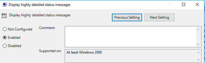

- Computer ConfigurationPoliciesAdministrative TemplatesSystem – Display Highly Detailed Status Messages : Setting – Enabled
- Computer ConfigurationPoliciesAdministrative TemplatesSystemLogon – Show first sign-in animation : Setting – Disabled
The first setting displays the startup component that is currently running instead of the generic startup messages. For example, you may see Applying Group Policy Software Installation if your machines are installing a GP deployed MSI. This setting was previously known as Group Policy Verbose mode. To make future troubleshooting easier, I prefer to enable this setting on clients and servers.

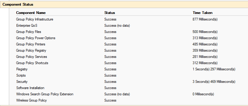

When running a Group Policy result within the Group Policy management Console on a Windows 10 machine, you will notice a new Component Status section under the Details tab. Components of Group Policy, such as Folder Redirection and Group Policy Printer Preferences, are known as Client Side Extensions (CSEs). This component status section will display the last evaluation status of each CSE. It will also display how long each CSE took to process. These values are also stored in the Group Policy event log on client machines.
This pane can help an administrator quickly troubleshoot Group Policy performance problems. Any item with a 600-second time failed to complete. The Group Policy service only allows a CSE 10 minutes to complete by default.

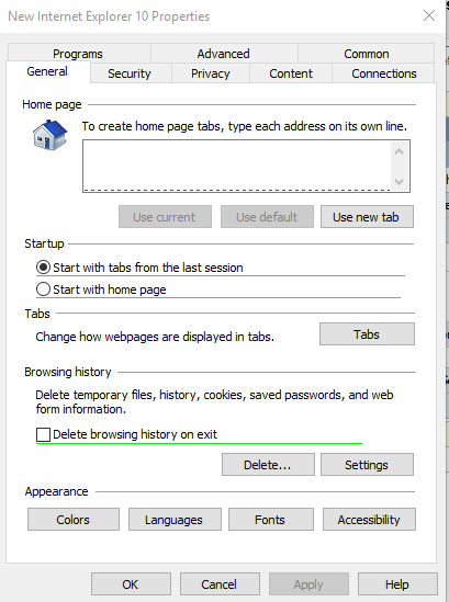

Group Policy CSEs have evolved with each iteration of Windows or the component that they service. A perfect example of this are the CSEs that manage Internet Explorer. One of the earliest management methods involved the Internet Explorer Maintenance (IEM) extension. IEM complemented many of the features available under Administrative TemplatesWindows ComponentsInternet Explorer. Several years later, Microsoft introduced Group Policy Preferences for Internet Explorer (IE). Having three management tools for one product became confusing for everyone!
With the release of IE10, IEM was removed from the GPMC on any machine on which IE10 was installed. This change holds true for Windows 10/IE11 as well.

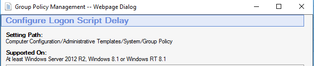

You will notice that user side Group Policy scripts is not listed above. With the release of Windows 8.1, GP scripts can be configured to fire off after X seconds instead of running during the logon process. This allows scripts to run behind the scenes after a user is already logged in. This setting can be found at Computer ConfigurationAdministrative TemplatesSystemGroup Policy
