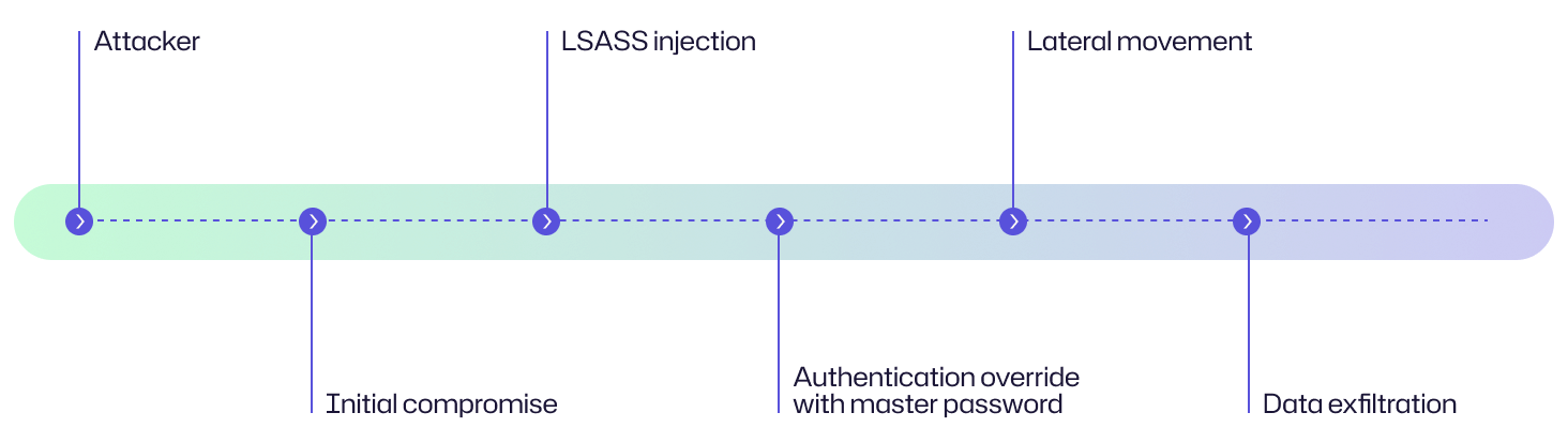

Attack flow diagram
Here is a visual flow of the Skeleton Key attack and an example story from an organization’s perspective that shows the typical chain of events, from an initial compromise to user impersonation, until attackers reach valuable data and exfiltrate it.
Skeleton Key attack flow diagram
Imagine Acom Manufacturing, which relies on Active Directory for identity and access. An attacker targets a helpdesk admin who reused credentials from a breached site. Using those credentials, the attacker logs into a management workstation, escalates access to a domain controller, and deploys Skeleton Key malware. With the master password accepted by the domain controller, the attacker requests Kerberos tickets, accesses file servers, deploys tools to collect sensitive IP and financial records, and exfiltrates the data without changing any AD password hashes.

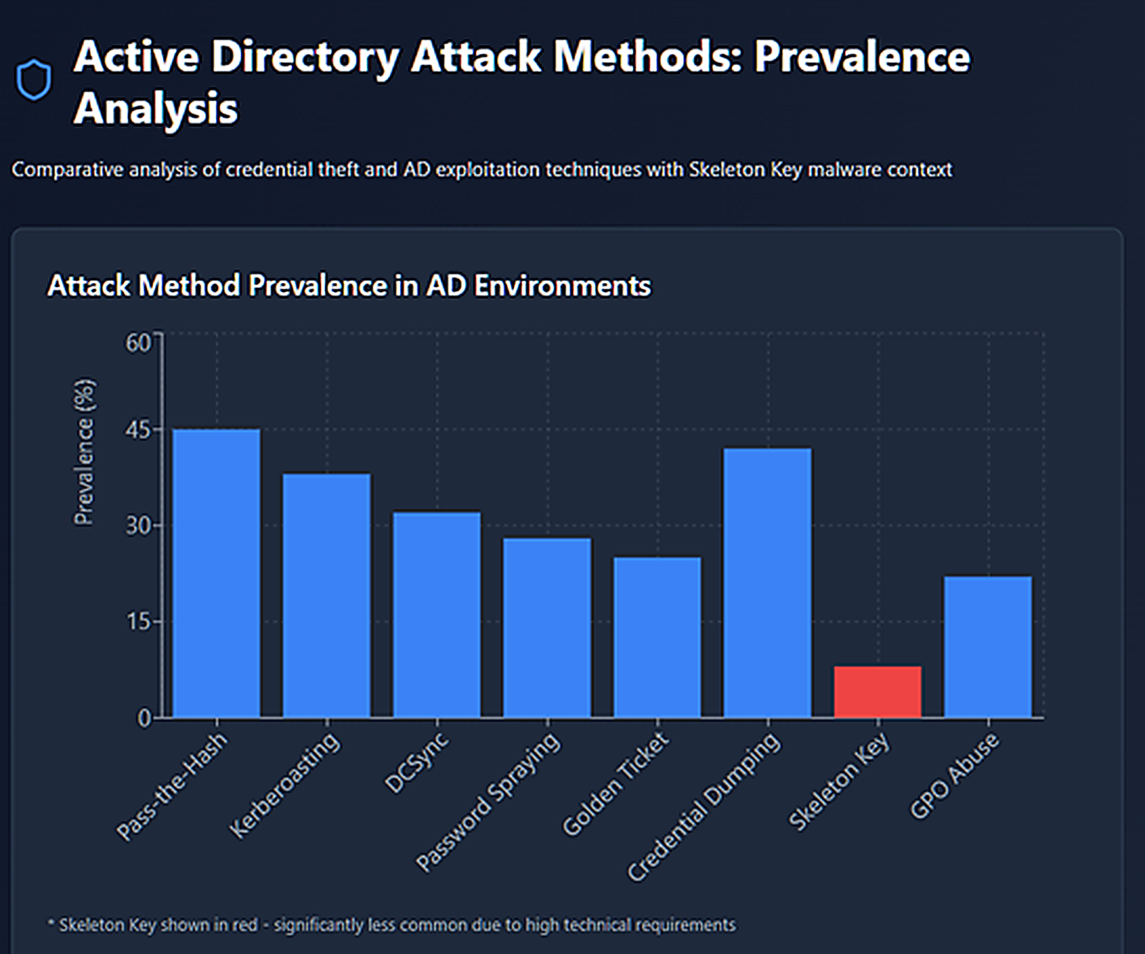

Key statistics and infographics
Let’s look at some facts and visuals that capture the scale and impact of Skeleton Key attacks.
  • In earlier Skeleton Key cases (around 2013 to 2015), researchers observed Skeleton Key being used in conjunction with Backdoor.Winnti, which suggests that it was part of broader intrusion and backdoor tool usage.
  • A HYPR/Vanson Bourne report from 2022 found that financial institutions experienced an average of $2.19 million in annual losses from breaches related to authentication weaknesses.
  • According to IBM's 2024 Cost of a Data Breach Report, breaches resulting from stolen or compromised credentials took the longest to identify and contain, with an average duration of 292 days. This allows attackers nearly 10 months of unrestricted access before discovery.
  • Experts strongly agree that recovery costs for domain controller compromise are significantly higher than standard breaches due to the need for complete Active Directory reconstruction.
