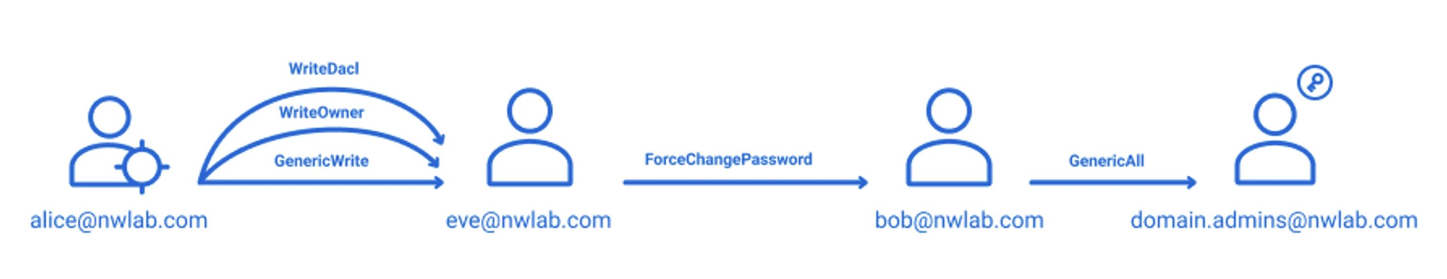

The graphic below illustrates an example. Suppose an attacker gains the credentials for the user account Alice. That account has WriteDACL and WriteOwner permissions to the user Eve, which means Alice can grant herself access to Eve’s account. Eve has rights to reset the password of the account Bob, and Bob has permissions (granted through AdminSDHolder propagation) to modify the Domain Admins group. Therefore, finding Alice’s password was very valuable the adversary!

After collecting data with SharpHound.exe -C All the adversary can load the data set into BloodHound to explore pathways to domain dominance.
