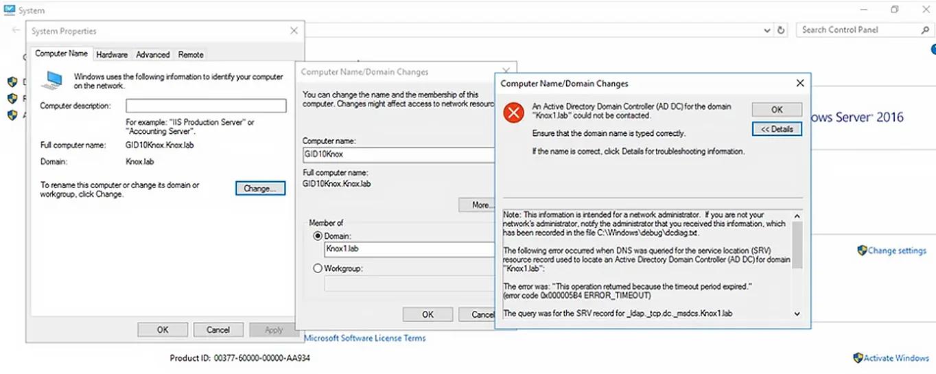

When I try to join a new Windows workstation or server to an Active Directory (AD) domain, I sometimes encounter the following error: “An Active Directory Domain Controller (AD DC) for the domain ‘domainname’ could not be contacted.”
This error can occur due to any of several reasons, from a simple incorrect DNS server IP address to a much more complex issue. In this blog, I will walk you through the steps you need to troubleshoot this problem, from the simplest to the most complex.
When the Error Arises

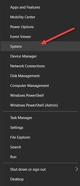

The error can be displayed when you attempt to join a workstation or server to a domain. Here are the steps that lead up to the error:

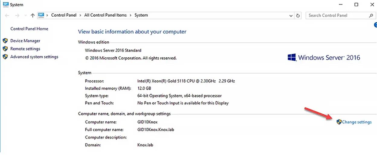

  1. Right-click on the Start button and select System:
when an error arises
  1. On the next screen, click Change settings:

  1. In the System Properties window, click the Change button. Then enter the name of the new computer and specify which domain you want to join it to, being sure to enter the FQDN (fully qualified domain name) of the domain. Click OK. This is when the error might be displayed:
Initial Troubleshooting Steps
First, ensure that you typed the domain name correctly.
If that’s not the problem, click Details to get information about the error.

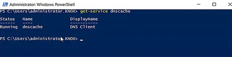

Make sure the DNS Client Service is Running
Next, check whether the DNS client service is up and running using this command:
[PowerShell]
Get-Service dnscache

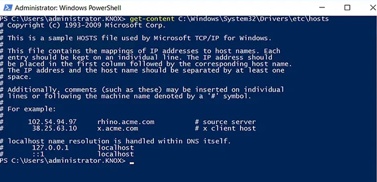

Check the Host File for Domain Entries
Make sure there are no entries for your domain or domain controller names in the hosts file located at C:\Windows\System32\Drivers\etc\hosts on the PC. Open the file with Notepad or any other text editor. If there are any entries for your domain or DC names, delete them.
To view the contents of the hosts file on the PC, use this command:
[Command]
get-content C:\Windows\System32\Drivers\etc\hosts

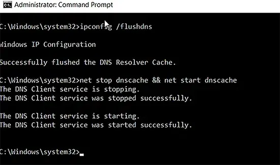

Restart the DNS Cache Service
Open an elevated command prompt and clear the DNS cache using this command:
[Command]
ipconfig /flushdns
Then stop and restart the dnscache service using this command:
[Command]
net stop dnscache && net start dnscache

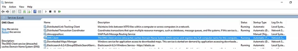

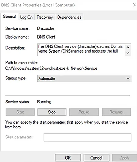

Alternatively, you can use the Service.msc console. Right-click on DNS Client to open its properties dialog:
Click use the Stop and Start buttons to stop and restart the service:

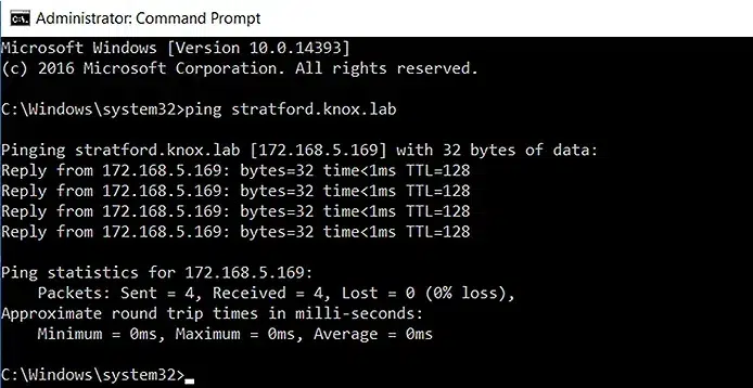

Check whether the DC is Reachable from the Client
To determine whether the domain controller is reachable from the client, first run the following commands from a command prompt:
[Command]
ping your_domain_name.com

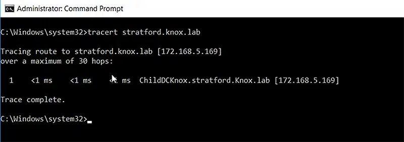

tracert your_domain_name.com
You should also check the availability of the DC from another workstation on the same network. If your client cannot access the DC but other clients can, there could be a problem with your client’s cable or hardware, or with a device in the middle. To narrow down the problem, try a different network jack or go wireless.

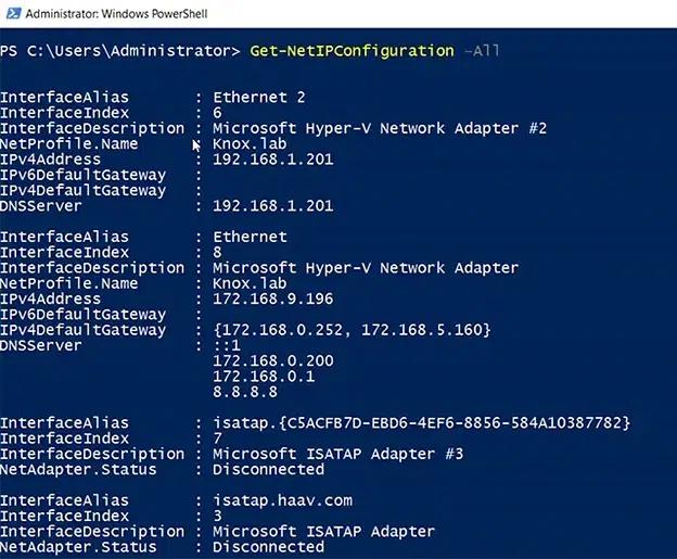

Check the DC’s Accessibility using PowerShell
Alternatively, you can use the following PowerShell cmdlets to check the connectivity to the DC.
To display the IP address:
[PowerShell]
Get-NetIPConfiguration –All

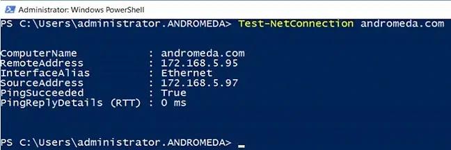

To ping the DC:
[PowerShell]
Test-NetConnection domainname

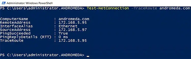

To trace the routes to the DC:
[PowerShell]
Test-NetConnection –TraceRoute domainname

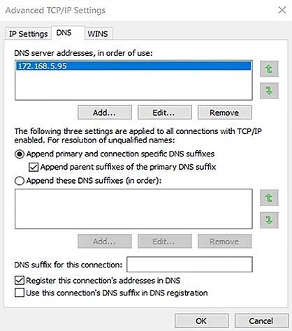

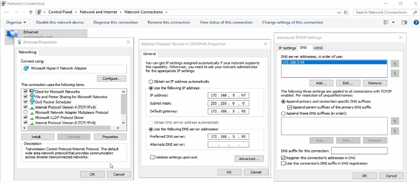

Add the DNS server to the TCP/IP settings of your Network Adapter
If the domain controller can be reached, try adding the IP address of your DNS server to your network adapter’s Advanced TCP/IP settings.

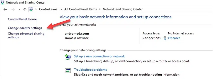

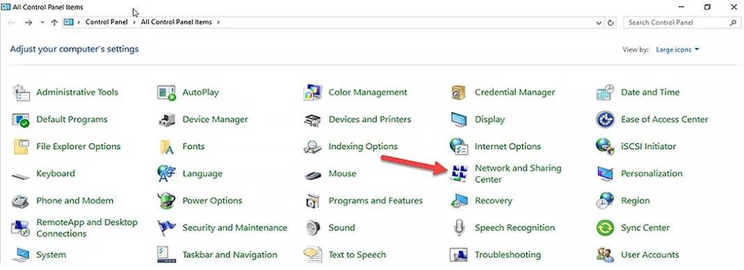

  1. Open Control Panel, click Network and Sharing Center, and then click Change adapter settings:

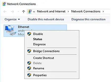

  1. Right-click on the network adapter and select Properties.

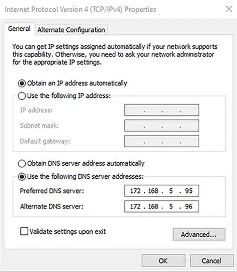

  1. Right-click on Internet Protocol Version 4 (TCP/IPv4) and choose Properties.
  2. Click the Advanced button and go to the DNS tab.
  3. On the DNS tab, click the Add button, provide the IP address of your DNS server and click OK. (Note that the DNS server might be a DC, especially if it’s a small organization.)
  1. If multiple IP addresses are listed, use the arrow buttons to move your preferred one to the top of the list. Then click OK.
  1. Click OK again to save your changes.
  2. Restart the workstation or server so the changes will take effect, and try again to join the workstation or server to the Active Directory domain.

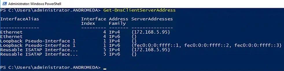

To check that your DNS server is one of these, use the PowerShell cmdlet shown below in a PowerShell session on a domain-joined PC. (If you don’t have another domain client to use, you will need to contact your network staff.)
[PowerShell]
Get-DnsClientServerAddress
Check whether you’re using the Right DNS servers
The DNS servers used by the computer running the cmdlet are listed in the ServerAddesses column.

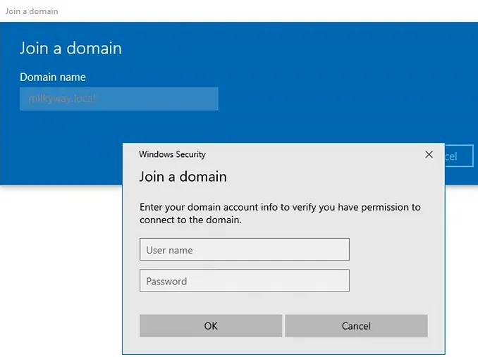

Option 2: Connect to the Domain through Windows Settings
Another option is to connect to the domain through Windows Settings:

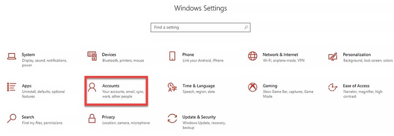

  1. Press the Windows and I keys on your keyboard to open the Window Settings window.
  2. Click Accounts.

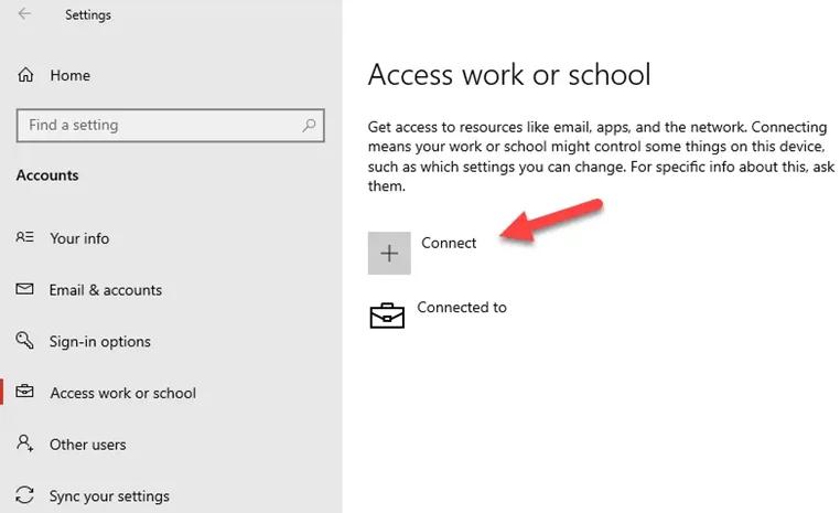

  1. In the left menu, click Access work or school. Then click Connect.

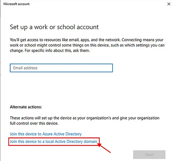

  1. At the bottom of the Microsoft account window, click Join this device to a local Active Directory domain.

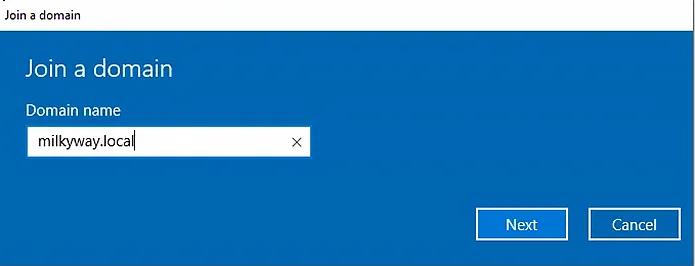

  1. Provide a valid, contactable domain name and click Next.

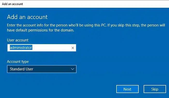

  1. Next, provide a domain account to use for joining this workstation to a domain. This account must have the permissions to join a workstation to a domain. Click OK.
  1. If you do not get an error, your workstation is now joined with the domain. On the next screen, provide a user account for this PC and then click Next.
  1. Click Restart so your changes will take effect.

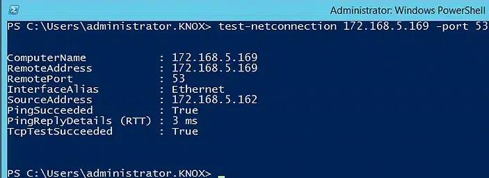

Check whether a Firewall is blocking port 53 on the DC
Check whether the DNS service on the DC is being blocked by a firewall. To see whether port 53 is available on the DC, use this cmdlet:
[Command]
test-netconnection 172.168.5.160 -port 53
Check the value of “TcpTestSucceeded”. A value of “True” as shown below indicates that the DNS service on the DC is operational.

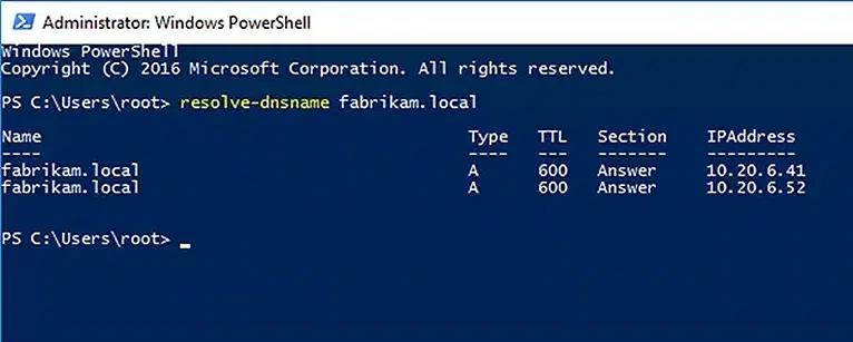

Check whether your Computer can resolve the Domain Name of the DC
Next, check whether the workstation can accurately resolve the domain name to the DC’s IP address. Use the fully qualified domain name of the domain to which you are trying to join your workstation with the Resolve-DNSName cmdlet, as shown here:
[Command]
Resolve-DNSName fabrikam.local
This command should return one or more DNS server records.

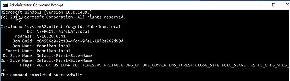

Check whether the Workstation can Contact the DNS server that hosts the DNS zone
Next, check whether:
  • The computer can communicate with the DNS server that hosts the DNS zone or resolves DNS names for the domain.
  • The DNS server for the client is configured correctly and that it is connected to it.
  • You can find a domain and connect to the DC from your computer.
To get the domain and DC information, along with the IP address, use the following cmdlet:
[Command]
nltest /dsgetdc:fabrikam.local
If the command completes successfully, it will return information like the following:
[Command]
DC: \\FRGC1.fabrikam.local
Address: \\10.20.6.41
Dom Guid: c64586c9-2c18-4fc4-9fe1-18f2a262d90d
Dom Name: fabrikam.local
Forest Name: fabrikam.local
Dc Site Name: Default-First-Site-Name
Our Site Name: Default-First-Site-Name
Flags: PDC GC DS LDAP KDC TIMESERV WRITABLE DNS_DC DNS_DOMAIN DNS_FOREST CLOSE_SITE FULL_SECRET WS DS_8 DS_9 DS_10
The command completed successfully

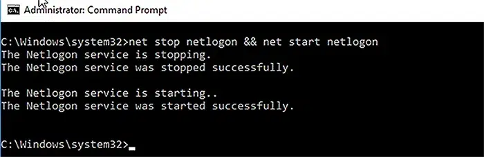

Restart the Netlogon Service on the Domain Controller
Restart the Netlogon service on the DC using this command:
[Command]
net stop netlogon && net start netlogon
Alternatively, simply reboot the DC.
When the server restarts, it will try to register the necessary SRV records on the DNS server.

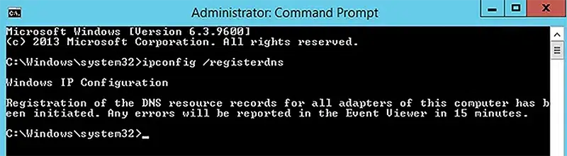

Re-register the DC’s DNS records by running this command:
[Command]
ipconfig /registerdns
Wait for the records to arrive in DNS and for them to propagate across the domain.
