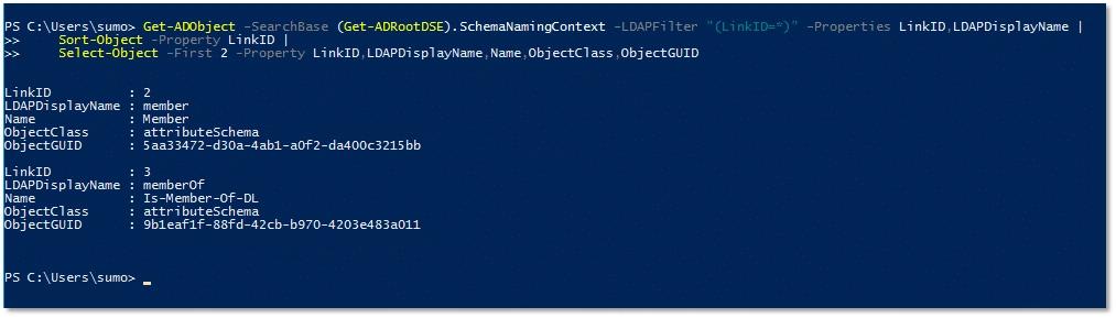

Every attribute in Active Directory is defined by an AttributeSchema object in the Active Directory schema partition. The AttributeSchema objects that define linked attributes are the only schema objects that possess a populated LinkID attribute. Accordingly, identifying all of the linked attributes in a domain is as easy as using PowerShell to search the schema for objects with a populated LinkID, like this:
Get-ADObject -SearchBase (Get-ADRootDSE).SchemaNamingContext -LDAPFilter "(LinkID=*)"

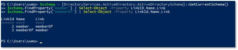

The attributes with the smallest LinkID values are the Member attribute and the MemberOf attribute, which are used to track group membership in Active Directory. So let’s modify our PowerShell script to limit the output to just those two attributes:
The output tells us several important facts about these two attributes:
- The LinkID value of the Member attribute is 2, which is an even integer. That means the Member attribute is a forward link.
- The LinkID value of the MemberOf attribute is 3, which is an odd integer. That means the MemberOf attribute is a back link.
- The LinkID value of the back link MemberOf is the LinkID value of the forward link Member attribute plus one (3 = 2 + 1). That means the Member attribute and the MemberOf attribute are associated linked attributes.

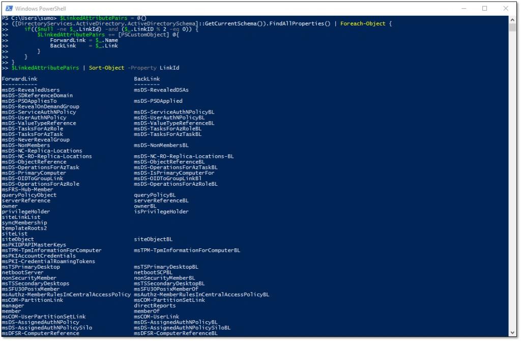

A slightly different PowerShell script can be used to directly retrieve the name of a linked attribute’s associated forward link or back link, though it doesn’t explicitly tell you whether the attribute is a forward link or a back link. You would need to look at the LinkID value and determine that for yourself.

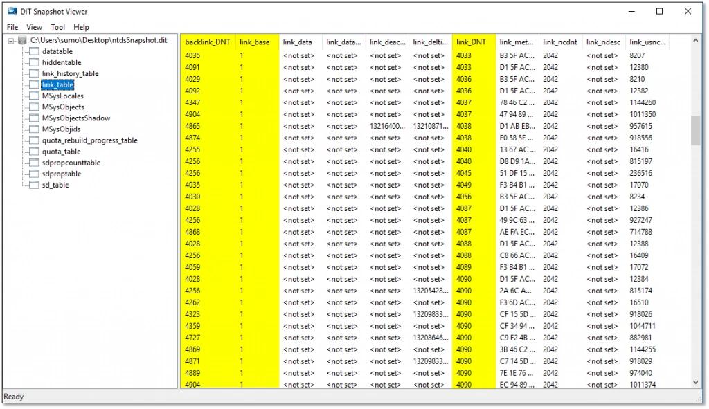

Active Directory data is stored in the ntds.dit database file. The values of conventional attributes are stored in a table called the datatable. Linked attributes have their own dedicated table, the appropriately named link_table. If we take a peek inside a snapshot of my lab’s ntds.dit database file, we can see how Active Directory stores linked attribute values:
Object references in the link_table make use of an object’s distinguished name tag (DNT), which is actually the internal primary key of records in the ntds.dit datatable. This prevents changes to an object’s distinguished name from requiring an update to any associated link_table entries.
The screenshot highlights three important fields in the link_table:
- link_DNT — A reference to a forward link object.
- backlink_DN — A reference to the associated back link object.
- link_base — A reference to the LinkID of the forward link attribute. This field uses the forward link’s LinkID value to identify the relationship being tracked between the two objects (though, as you can see in the screenshot, the values in the table are actually the LinkID value divided by 2).

To illustrate why this is important, let’s consider adding a user to a group. This update modifies only the group’s Member attribute; the user’s MemberOf attribute is not modified. Since the group object had a material change, the metadata fields that reflect that change (e.g., the “ModifyTimeStamp” and “WhenChanged” attributes) are updated. Those same metadata fields are not updated on the user object because, even though its MemberOf attribute will now return a different value, the MemberOf attribute itself wasn’t modified. - Forward links are mandatory; back links are optional. Some articles on linked attributes state that linked attributes always have both a forward link and a back link. While that is often true, the presence of a back link is not strictly necessary. In fact, if we use PowerShell to retrieve linked attribute pairs, we can see that not every forward link in my lab has an associated back link:
